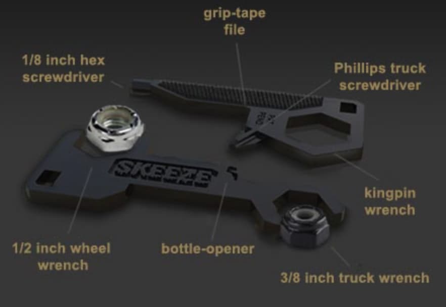

Here you can see our multi-tool:
61085-1
It is currently offered in a hot black oxide finish.
We want to offer these in colors, such as gold or hot pink, etc.
It seems e-coating would be nice and thin, unlike powder coating. This is good so our wrenches fit right.
Still, question one is: what thickness of e-coating would you recommend and should we be subtracting this thickness on the sizes of our wrench openings in our 3D model before investment casting these? If we weren't e-coating these, the engineer would adjust our model as needed to account for any shrinkage or expansion in the material after heating and quenching/tempering.
We take delivery in France and the U.S. so these can be finished in China or Europe or the U.S. depending on the batch, etc.

A. Hi Don. I think E-coating will probably be somewhere about 0.0002" -- that's 2 ten-thousandths not 2 thousandths. To my understanding it is not typical to adjust dimension of tools of this nature for thicknesses in that range, but I would ask a vendor to do a couple of sample parts and see what you think of it before committing to the process or adjusting your other steps. (Readers/responders usually enjoy having as full a picture of the poster's situation as practical, so we note Don's earlier posting on topic 25543).

Q. The factory making the keys just said they think e-coating would peel off so is there a better alternative? I assumed e-coating was better than paint due to thickness and powder coating would be more likely to chip. Open to suggestion.

A. Hello again Don. Although there is obvious truth to the fact that organic coatings (paint, powder, e-coating) are softer than metal and are not as wear-resistant, chip resistant, and strongly adherent as metal plating, e-coating should be fine.
Proper adhesion is a matter of proper cleaning and pretreatment. Send a few of your existing keys out for sample e-coating. I think any organic coating will chip/wear off the tip of the phillips screwdriver pretty quickly, but based on your earlier postings, and people's normal experience with phillips screwdrivers, I wouldn't expect this to be a big deal.

thumbs up sign Thanks, I hoped for that answers I will make samples the goal and not likely modify the 3D models. I will solicit estimates once the casting process is done. Takes about 35 days. We are changing a few things like the logo on the existing tool.
