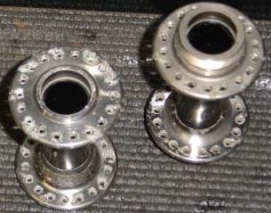

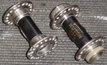

Q. My name is Alan McCorkle and I collect/restore vintage BMX bicycle parts. I am particularly interested in items manufactured by a company called Hutch Hi-Performance Products and Titron Titanium Components. Hutch, owned by Richard Hutchins, was in business from the early 80s until the late 80s and they were located in Pasadena, Maryland (later Baltimore). Hutch made many different bicycle parts including frames/forks, cranks, hubs, pedals, and various other components. They are most well-known for their round beartrap style pedals, use of exotic metals such as titanium and magnesium, and their love of chrome plating. Most of the Hutch components including the pedals and magnesium sealed bearing hubs were designed and manufactured in 1980-81 by a company called Titron Titanium Components in Lemont, PA. Titron was owned by a Mr. Bill Grove who would eventually go to work for Hutch when his company and product designs were purchased by Hutch in 1981.
The component I need help with is the magnesium hub which was made from AZ31B magnesium. The hub is a 3-piece design with the flanges being pressed onto the center of the hub. The hub also used titanium axles and sealed bearings. The hubs were available in several different finishes including: a matte gray finish (which I am told was electroless nickel), chrome plated, black, and a two-tone finish where the hub flanges are nickel plated and the hub center is a semi-gloss black finish that almost looks anodized. I have learned that the coating used under the black finish is most likely Dow #17 (described by Mr. Bill Grove as an ugly green color but he does not recall the entire finishing process since it was outsourced and it was 20+ years ago) but it is the final black finish that remains a bit of a mystery. The inside of the hub center is also the same black finish which seems to suggest that it is not painted or powdercoated and the finish does not chip or flake.
My questions are:
1) What coatings other than powdercoating or paint would have been used over Dow #17 to produce this black finish?
2) Is it a "black" finish or a product that when applied over the Dow #17 creates a black color?
3) Would Dow #17 also be used under the nickel finish?
The nickel plated flanges of the hubs are in fair condition with some pitting where the nickel finish has expired (for lack of better description). Is it possible to repair the pitting in the magnesium prior to refinishing? Can these pits be filled with another material?
I am very interested in learning about all of the different possibilities for restoring these items. Pictures of the hubs are available here:
mag bike sprockets 1  mag bike sprockets 3 mag bike sprockets 4
Alan McCorkle
