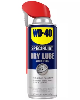

Applying Teflon to non-anodized aluminum?
WD-40 Dry Lube PTFE Spray
wd_40_drylube
Q. Greetings and thank you for sharing your knowledge!
I'm looking to put a protective coating on a recently resurfaced aluminum platen to prevent recurrence of oxidization. The part is a component of a printing press that can expect temperatures up to 230 °C.
Prior posts in this thread noted that prior to Teflon coating, the aluminum must be anodized. I'm not totally sure, but I don't think this surface is anodized. Any suggestions?
I had been thinking of using something like WD-40 Dry-Lube PTFE ⇦ on eBay or Amazon [affil link]
Morgan Chivers
- Arlington, Texas USA
July 16, 2019
