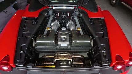

Hello! I have a small quantity of like 15 titanium 4-6 mm bolts, 28 washers. I need them colored black to match some carbon fiber engine covers on a Ferrari F430.
titanium bolt kit   Ferrari carbon valce covers
We make titanium parts for all cars on a custom basis. I am buying this set ready-made in USA and my vacuum vapor deposition apparatus is across the planet, so it's silly to send them there if someone can do it here ... and we would like to have a source in USA for future projects.
Would like fade-free tough black finish for this project. I am developing aftermarket engine cover bolts kits.
