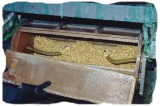

a. The two most common types of barrels are the horizontal barrel which is a hexagonally shaped cylinder and the oblique barrel which closely resembles a cement mixer in both looks and operation.
b. While the barrels may be made out of virtually any material they are usually constructed of rigid polypropylene because of its chemical resistivity.
c. In order to allow the plating solution to enter and exit the barrel without loss of the parts to be plated, holes are drilled along each side of the barrel and the removable panel called the door. The number of holes should not exceed 30% of the surface area of the barrel or the structure of the cylinder may become too weak. The holes must be properly sized so that parts do not fall through while being large enough for solution to easily drain to minimize wasted chemicals. For this reason platers keep a variety of hole sizes available along with a variety of barrel sizes.These sizes can include barrels with diameters of an inch up to monsters 24 inches wide by 60 inches long.
d. The interior surface of the barrel must also be designed correctly to promote adequate tumbling of the parts. Ridges or dimples are added to prevent parts from sticking to the sides and "nesting" which could be detrimental to good plating distribution.
e. The exterior is shaped like a hexagon to provide a pumping action so plating solution can be replenished as the barrel rotates.
f. There are a number of different methods to carry the electrical current to the parts one wishes to plate. Some barrels have small metal buttons strung along their inside surface which are connected through a cable to an external power supply. This method might be used for large parts which could become tangled to assure they all are making electrical contact. Another method is to place large discs on each of the two sides of the barrel to assist in the plating of long thin parts which might damage internal protrusions. By far, however, the most common way to supply current to the parts is the "dangler". This is usually a coated cable with a large metal ball crimped onto the end which terminates inside the barrel and simply rides on top of the parts as they tumble in the cylinder. They enter the barrel through a hole machined out of each end of the barrel and are then connected to the rectifier which will supply the D.C. current to power the chemical process.
g. The maintenance of the barrels is greatly reduced by constructing them of chemically resistant materials such as polypropylene, poly-glass, stainless steel and Koroseal coatings.

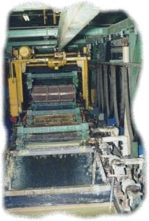

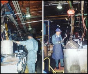

a. Load parts and close barrel
b. Place loaded barrel into hot alkaline cleaner tank and rotate 3-5 minutes to remove oils and grease, then rinse in fresh water.
c. Immerse barrel next into another hot cleaner tank which is electrified in the opposite fashion of the plating tank so as to "de-plate" the parts and remove soils and some light scales. Rinse as before.
d. Rotate barrel in acid dip which can contain such chemicals as hydrochloric, sulfuric, nitric acid, or dry acid salts. The purpose of these chemicals is to remove any rust,activate the surface of the metal and neutralize any residual alkalinity left on the parts from the cleaner tanks. Rinse thoroughly.
e. Now you are ready to plate the parts based on the needs of the customer. The length of time in the plating tank is determined by the thickness of metal to be plated. The greater the thickness the greater the time. As always, rinse when done.
f. Having plated the part you may now apply any number of post treatments including but not limited to: oils, waxes, sealants,chromates or other metals such as brass and chrome. Yes, you still must rinse.
g. Unload parts into a drying unit and dry completely at no greater than 120 degrees F.
dryer
