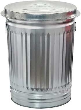

Galvanized Trash Can
Galvanize & galvanneal are very similar. Both are produced using a hot dip process. In fact, the same production line may produce both products. Galvanneal is merely galvanize which has been annealed. The annealling furnace is down stream from the zinc bath. Turn off the furnace and you produce galvanize. Turn on the furnace and galvanize is turned into galvanneal. Galvanneal has a dull grey smooth surface. It is used for painted applications. Galvanize has a bright zinc crytyline surface. Like galvanize garbage cans.
