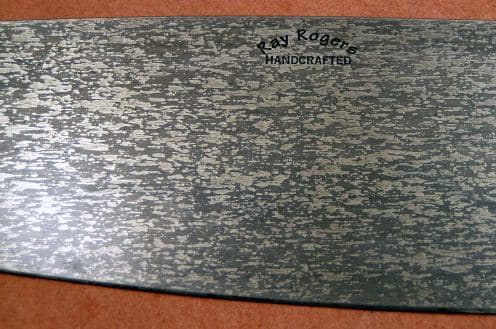

Q. A knife maker I know of and talk with now and again recently had an odd pattern etch in a piece of O1 tool steel. I'm going to quote his post over on https://www.knifenetwork.com/
"I think someone may have had an experience like this before but I don't think any definitive answer was offered and maybe there won't be one now either but I thought you guys might like to see this. I have etched O1 blades many times before, usually in FeCl, to give them a nice gray appearance and a little rust resistance. This time I use white vinegar in bulk on eBay or Amazon [affil links] for a whole hour to see if the pattern would go away and get a flat gray but it didn't happen. I did rinse the blade in water a couple of times. Anyway, if some of you with more metallurgical knowledge than I have would care to offer an opinion it could be educational for us all. I'm thinking maybe this O1 is a PM steel and we're seeing the distribution of alloying elements ..."
etching on tool steel
Now I've become very curious about what made this pattern come out in the etch and would like to be able to replicate it, failing that I'd like to just know what is going on here.
