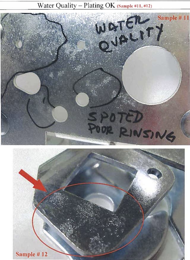

Q. Our plant has been receiving steel parts plated with a trivalent zinc chrome coating that have a variety of blemishes. We are attempting to determine which types of blemishes in this type of coating are ones that affect the coatings performance and which ones are acceptable/passable for use.

Samples 11 - 13: Are spots caused by poor quality rinsing water an issue, or could they be passed?

Sample 3 is from a badly maintained plating bath (blisters on the edge) and the water mark you see is either from the base metal ooze out or improperly dried and rinsed in hard water in the end.

WE WANT TO GET RID 100% THE WATER MARKS WHICH APPEAR BELOW THE BLUE ZINC PASSIVATION. PLEASE SUGGEST.
