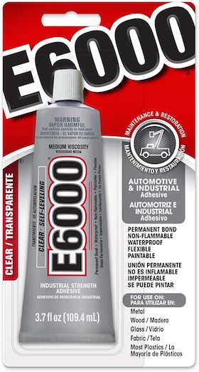

"E6000 Auto/Industrial Adhesive"

I covered the edging of my counters - it's a bullnose wood edging - in copper sheeting. I used E6000 glue ⇨
which served it's purpose for me. It's not very smooth but then I wasn't looking at that. The copper doesn't stay shiny and I haven't polished it since I put it on (about 2 years now).
