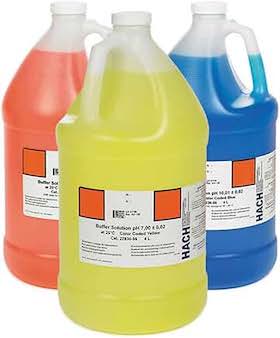

Make sure you have a pH 1 buffer to calculate offset. Are your measurements correct?

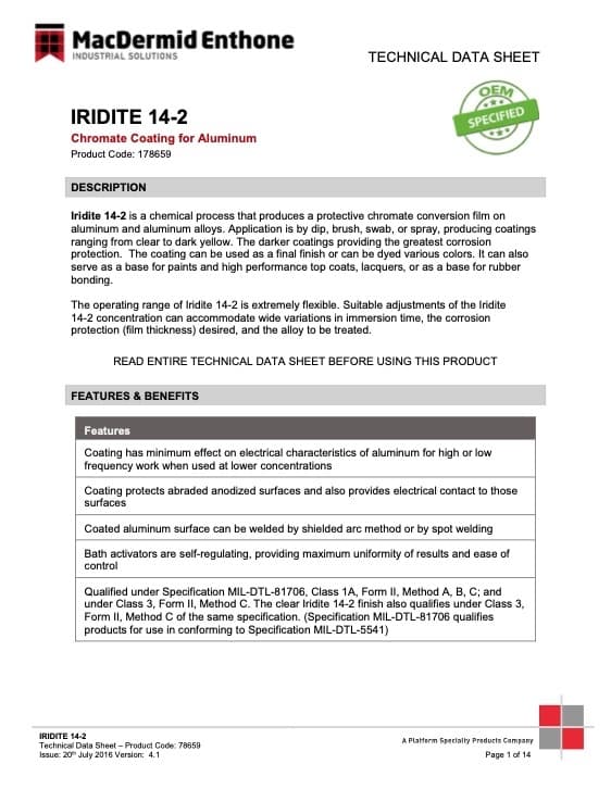

I actually really trust the manufacturer data sheet. If you're staying towards the middle of their concentration / pH brain teaser, you're fine.

If you are running Iridite you will ABSOLUTELY need to have a bottle of pH 1.0 buffer solution to check your accuracy. Calibrate your meter as usual with the two-point 7 & 4 buffers, then rinse the probe well and stick it in a small beaker [beakers on eBay or Amazon [affil link] of 1.0 buffer. If you can find 2.0 buffer, that will also work for this application. Give it some time to equilibrate. When the reading stabilizes, record the value. If your meter is anything like mine, it will not hit 1.0 on a two point calibration. So if your Buffer 1 reading is 1.2, apply a correction factor of 0.2 to your tank reading.
Another thing to note is that the correct pH of the solution is (according to the manufacturer) concentration dependent. So at 0.75 oz/gal the given target is 1.75. At 1 it is 1.6. At 1.25 it is 1.45. Do a titration to find your true concentration before you set the pH. Now, this is information directly from the tech sheet. I have had a consultant suggest a target of .85 oz/gal and pH 1.85, fresh from stock, without the addition of any old tank 'heel' or copper or chloride, just a little scrap aluminum to pre-condition the bath. At that combination the coverage and color is excellent. That was run as a bucket test which is a great way to evaluate your mix without committing to a whole tank.
