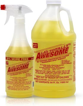

LA's Totally Awesome Cleaner
A. It sounds too simple to show any results but I use LA's "Totally Awesome" to clean engine blocks and such, and without any agitation or a brush or anything like that, it just eats it away. I usually get like 20 bottles and pour it all in a plastic tub and let the parts soak for about half an hour and they come out like new. Just rinse them off and dry. Hope this helps.
