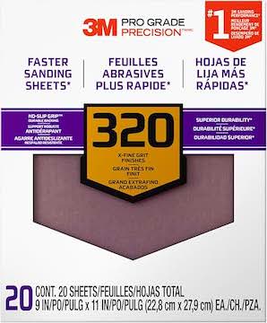

Go to a hardware store and buy several sheets of 3M Tri-M-Ite 320 grit sandpaper. ( It's a bluish white color.) and a maroon Scotchbrite pad.
Seal the wood with the lacquer sanding sealer, sand the furniture with 320 grit Tri-M-Ite (3M product) and spray on another coat of lacquer sanding sealer, but do not sand it.
Wait 25-30 minutes while the sealer dries then spray on a coat of the Krylon semi-flat black. Once the semi-flat black dries rub edges and wherever else you want with the Scotchbrite pad to remove the black paint. Rub gently at first. Use ONLY the products I specifically name-do not let the people at Lowe's or Home Depot or elsewhere tell you "This is just as good." because it's not. Lacquer is different than acrylic or enamel and they are not compatible with one another.

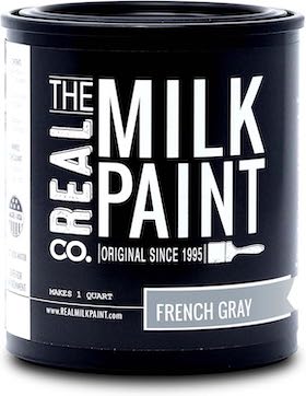

Milk Paint
A. If you are having trouble with the lacquer, please try cleaning this back off with lacquer thinner this on eBay or Amazon [affil links] Warning! highly flammable! , then wiping clean with acetone this on eBay or Amazon [affil links] Warning! highly Flammable! . Sand and paint with a milk paint (black), from "general finishes" if possible, then sand through the edges to the wood, then top coat with two coats of clear. All of this is done with waterbase products and probably won't bubble on you. You can go to generalfinishes.com to look at more samples. I refinish custom furniture.
