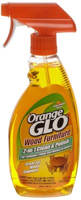

A. Hi Olivia,
From just the photograph it looks like you've just removed some darker oxidation, but have not introduced mismatched scratch marks ... so the first thing I would try is nothing, just allowing time for that area to oxidize and darken the bright spot for a couple of weeks. Please let us know if that works.
If it doesn't seem to be darkening by itself, see Demetra's posting about Orange Glo. Although I've not familiar with using that product for this it sounds like Demetra used it and the bright spot disappeared in a few days.
The most important thing is always to not make it worse, and that's easy to do  🙂

I'm going to try "Scratch Be Gone" but I also wanted to say "Orange Glo Stainless Steel Cleaner and Polish" made the fine scratches disappear (which I foolishly made on my stainless steal fridge using a dish washing grainy sponge). I used the Orange Glo to polish up the fridge a bit after I made the scratches and a few days later the scratches are gone.
Wow!
