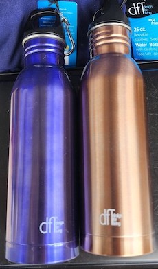

thumbs up signAppreciate the replies here! I stumbled upon this while googling "stainless steel" and "lemon", together, as I have a "Designed for Living" stainless steel water bottle, and was wondering whether my adding a couple of lemon wedges into my water would introduce any type of corrosive affect on the interior of the bottle.
From the replies I see here (perhaps contingent on the grade/type of stainless), I shouldn't worry. Thank you.
