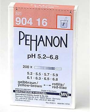

Pehanon pH Paper Strips
pH_paper_Pehanon
If you choose papers, I recommend the Pehanon brand. The color chart is right on each strip, so you're not wondering whether the wetness is throwing you off.
