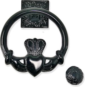

Q. My friends have a solid brass Claddagh door knocker for their new house. However, all the other door hardware is an oil rub bronze finish. Is an oil rub bronze finish available to spray or hand finish the knocker to match?
Joyce J. Shea
consumer - Magnolia, Massachusetts
A. To my eye, oil rubbed bronze is a brown-black finish with copper-ish or brass-ish tones showing through at the corners and wear areas. The brass can be generated with brass darkening solution on eBay or Amazon [affil link] or liver of sulfur, and can be relieved back to brass color at the corners and wear areas with ultrafine steel wool on eBay or Amazon [affil link] . It should be close -- but such relieving requires some artistry skill.

Q. I very much enjoy this thread. I have been looking for years (unsuccessfully) to finish my raw metal tank and fenders of my custom motorcycle with the look of oil rubbed copper/bronze. Can these techniques or something similar be used for a motorcycle paint or finish job that will keep the integrity of the metal?
34482-1a  34482-1b  34482-1c
Jeffrey Topping
- Cincinnati, Ohio, usa
March 24, 2015
A. Hi Jeffrey. With a properly applied rugged clearcoat -- probably a 2-component automotive clearcoat -- the oil rubbed bronze will have pretty good durability. Finishing.com did a corrosion study for ILZRO/IZA a couple of years ago and an antique bronzed finish (blackened copper plating) with clearcoat performed exceptionally well in corrosion testing.
