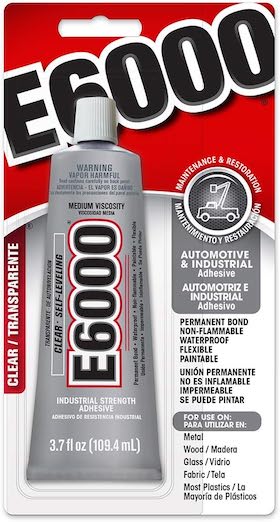

"E6000 Auto/Industrial Adhesive"
A. When dealing with bleach (sodium hypochlorite) of 9-15% concentration its always best practice to follow the manufacturers specific instructions to the letter while making the solvent welded joints to include cure times. When pressurizing the bleach, don't get excessive or you can expect to have many leaks as it will eventually eat the glue. Also, avoid threaded connections like a heart attack! Teflon tape will hold on a no/low pressure threaded connection, but I have found that a simple hobby glue called E-6000 ⇨
works best on mid to high pressure systems but also needs 24-48 hours cure time for best results.
Also, stainless steel and ductile iron are not a cost effective choice due to the fact that the bleach will eat the pipe extremely quickly, try to stick with thermoplastics as much as possible.
hope this helps:)

Q. To Chris Smith in Kansas: Can you provide examples of where you have you used the E6000 adhesive [←affil link] in a 12% hypochlorite application? How long have these systems been in service without leaks? I have a project coming along that will involve trade solution product and I'd like to have some evidence to offer the client before I propose using a product not generally considered for use in this industry.

A. Damien Stella, I work with 10% and 12.5% Bleach solutions on a daily basis doing water treatment for Wolf Creek Nuclear Power Plant. We routinely used E-6000 [←affil link] on all threaded PVC and plastic pipe joints in our old Bromination system as the pressure that we had to over come was approximately 150 PSI. we saw far fewer leaks from the threaded joints using this hobby adhesive than any other thread sealing compound that we could get on the market. we have a newer system installed now that is a low pressure Neat feed system that injects chemical at less than 5 psi and the E-6000 [←affil link] is still in use as we have found it to be the proven to not leak. we also no longer use diaphragm pumps as they would literally hammer the system to a point where it would leak. our new pumps are gear driven PULSAFEEDER Eclipse series pumps.
Also, if money is not an issue with your upcoming project, you might check into socket thermo welded Kynar plastics, the Kynar (PVDF) pipe is currently used on our system for the delivery piping and when thermally welded correctly will not leak because the plastic for both the male and female parts of the joint are melted and then pressed together bonding them permanently. hope this helps

Q. Thank you, Chris Smith!
I am hoping you can lend me some expertise.
Am trying to convert a 58 gallon water tank to use for Sodium Hypochlorite or Calcium Hypochlorite bleach.
Have a polypropylene Banjo bulkhead at the base of the tank that is going to be plugged. Have heard that is bad idea, the SH will eat away the EPDM gasket, etc., and cause it to leak. Inadvisable to have any holes in tank other than on top, but I have a good tank, otherwise. Just has the hole near the bottom.
Will E6000 [←affil link] seal it? Will it last forever? <grin> The tank is for a low pressure roof and exterior cleaning delivery system (5 GPM).
It says on the E6000 package [←affil link] that it is not for polypropylene. Bulkhead and plug are threaded, too.
I apologize if this is not on subject, but this thread is where I got the idea of using this glue.
Any ideas?
Thank you for your time, hope you don't mind,
