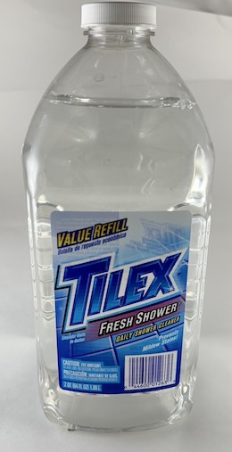

Tilex Shower Cleaner
A. I have removed water stains from stainless steel by spraying it with Tilex Fresh Shower Daily Shower Cleaner and letting it sit for a day. Then re-clean it with the same stuff the next day. Repeat if necessary. The EDTA in the cleaner will eat away the mineral deposits, which is the problem, without damaging the steel. I think most any brand of daily shower cleaner will work but this is what I used (I like the smell).
