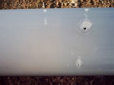

Epoxy Putty
Q. Corrosion repair on aluminium mast. I have a high performance catamaran with a light weight anodised aluminum mast. I have found a corrosion perforation where some salt was trapped under the mast rest on the trailer. I have washed it down with spirit vinegar in bulk on eBay or Amazon [affil links] to neutralise the area. Can anyone advise on the best method of fully neutralising the corroded area & best repair technique? I am considering drilling the corroded area out then filling with a neutral cure silicone sealer (strength is not a concern but full sealing against water ingress in the event of a capsize is crucial).
Any advice gratefully received.
