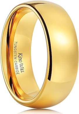

Danib, specific gravity is not an accurate way to determine purity of gold. The element tungsten has a very high specific gravity (19.22). While it is very close to that of gold (19.32), it is a relatively cheap metal. A bar of nearly pure tungsten could be coated with a thin layer of pure gold, and it would fool many experts into believing the entire bar was close to pure gold using any type of specific gravity method. It is helpful as a double check but not for certainty.
The most accurate ways to determine gold's purity is for it to be melted down and separated from its base metals or to use an X-ray Spectrometer device specifically designed to analyze its alloy concentration. These are very expensive -- in the multiple thousands of (USD) dollars to purchase.
There are even companies that specialize in making tungsten jewelry plated with gold!
tungsten-alloy.com/tungsten-alloy-fake-gold-jewelry.html
