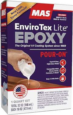

A. Hi, Josh. Multiply the length in inches times the width in inches times the depth in inches for the volume of clearcoat needed in cubic inches. A gallon is 231 cubic inches, so divide by 231 for the volume in gallons. Good luck.
