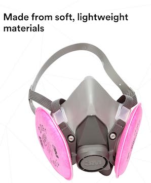

Respirator, Sanding
A. THE MOST SENSIBLE SUGGESTION TO YOU WOULD BE IS TO MAKE SURE YOU ARE RESPECTING YOUR HEALTH BY WEARING A MASK, PREFERABLY A CHARCOAL FILLED MASK AND TRY NOT TO GRIND TOWARDS YOURSELF IF THERE ARE NO FUMES, THERE SHOULD NOT BE A STRONG CONCERN. WHERE THERE ARE FUMES NORMALLY AN EXHAUST SYSTEM SHOULD BE USED AND TRY TO WORK IN AN OPEN AREA.
GEORGE TOH
- CANADA
A. In reference to the respirator advice given above, for protection from particulates (fumes, dusts, etc.) you should have a respirator with a particulate filter (such as a N-95, or HEPA filter). A charcoal filter will only work for vapors, such as solvents. A charcoal filter will provide no protection against fumes or dusts.
As a side note, a particulate filter respirator can cause some degree of stress, as it is more strenuous to breath through them. OSHA requires that employees who wear respiratory protection undergo a medical review to ensure that wearing a respirator will not endanger their health. Though it is not common, some individuals with an underlying physical ailment such as cardiovascular disease or asthma may be adversely affected by wearing respiratory protection.

Respirator
A. To fully protect yourself, I would highly recommend a 3M Particulate Filter 2091/07000(AAD), P100 Respiratory Protection or at the very least a dust mask. I work with galvanized steel on a consistent basis. I know what it is like to get ill from breathing or being exposed to fumes and inhaling the galvanized dust. It's some bad stuff. If you're questionable about it, put on some PPE. Be safe out there.
