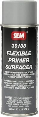

# You are now ready for the priming process. I used a flexible primer manufactured by SEM. It is available in quarts and possibly aerosol. The SEM part number is 39134 and it is called Flexible Primer/Surfacer. This is a great product and builds nicely. It can be sanded after 45 minutes. I apply at least 2 heavy coats, let dry, then wet-sand using 220 grit wet/dry sandpaper.
# The tank should now be thoroughly rinsed and dried. Apply another 1-2 good coats of SEM # 39134 Flex-Primer. Let it setup (dry) then wet sand using 400 grit sandpaper. Thoroughly rinse again, and assess your work. It is possible that the tank may need another application. If so, repeat as necessary, final sanding with 400 wet. When finished, rinse the tank again thoroughly, both inside and out, and let dry. On my original Can-Am MX-3 red fenders I had to perform the priming/filling process 3 times to remove all the scratches, as one of the fenders was really bad to begin with.

A. Hello all,
I am pleased to report that have very successfully painted a plastic fuel tank on the dirt bike, used it for racing and many weeks later all is good.
Special materials:
acetone this on eBay or Amazon [affil links] Warning! highly Flammable!
fuel tank liner from Blue Lightning Products
adhesion promoter spray can from SEM.
flexible primer from SEM.
(zinc plating kit)
Procedure:
Thoroughly wash the tank inside and outside with acetone several times over several days, weekends to remove any trace of old fuel, grease etc
Removed rust and zinc plated the metal piece of the tank opening. Obviously this has a lot of sub-steps but not the point of this article.
Poured a pound of wood screws inside the tank, wrapped it in a blanket, and ran it for 30 min in a wash-drier. The intent is to roughen up the inside for the liner to grip well.
One more shot of acetone inside and leaving everything to dry thoroughly
Lined the inside of the tank as per method indicated on the can. This is a little strange as the liner takes a long time to dry. When left overnight, most of it sets at the lowest point and I wasn't sure there was any liner left on the other parts of the tank. So I did it twice over two week ends. The liner is a super thin and hard green layer.
Sanded the exterior of the tank
Cleaned again with acetone and thinner
Applied the adhesion promoter
Applied two layers of flexible primer
Flatted the primer obviously: that primer is super hard, incredible
Applied two layers of base coat
Applied two layers of clear coat
Got really very pleased with the result
All details and photos here:
http://www.xr500only.com/restauration-tips/how-to-paint-a-plastic-tank-and-use-it-normally
