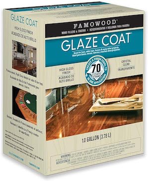

Famowood Pour-on Epoxy
A. There are several brands out there, I have been using Famowood by Eclectic Products [affil links]. I have also been doing a search online to find a more reasonable cost. Be well and much success to you!
