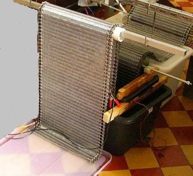

Polishing & passivating stainless steel conveyors & platforms
Q. I own a company that fabricates conveyors, platforms, and items for the food industry. We never really have a problem with any of our stainless steel, but I have noticed that in a few different rooms at different companies, some stainless steel is rusting. It may be our stuff, it may be from another company that specializes in stainless.
We currently just use scotch brite pads on die grinders [adv: die grinders on eBay or Amazon [affil link] , with some minor polishing compound. We have to keep everything food safe so we don't use much in the field.
What are efficient ways to clean/passivate stainless in the shop, without taking it to a passivation shop. We always try to passivate, but our time frames may not allow that to happen.
Most things are just tig welded with no sanding of welds.
John Allen
- New Jersey
August 20, 2015
A. John,
A lot of food equipment (and other large fabrications) these days are passivated with a citric acid based gel/paste type product. This allows you to do it yourself safely and with no immersion tank.
There are versions that remove rust as well as passivate that your customers can use on their affected equipment. Most of the time that will start popping up due to bleach or otherwise high chloride cleaners being used. Also unpassivated welds tend to go first, especially in instances of cross contamination with mild steel.
Let us know if we can help.
ray kremer
Ray Kremer
Stellar Solutions, Inc.
McHenry, Illinois
stellar solutions banner
A. John,
There can be some ways to solve this problem:
1. Passivate by spraying or applying passivating gel locally (you can deliver the gel and instructions to your customers).
2. During conveyer manufacturing stage, add additional step of electropolishing it. This way you prevent ways ahead rusting problems.
See attached picture of our tests of continuous electropolishing of conveyor line.
12132-2
Contact me for more information.
anna_berkovich
Anna Berkovich
Russamer Lab - Pittsburgh, Pennsylvania
(ed. update July, 2025: sorry, Anna has retired)
