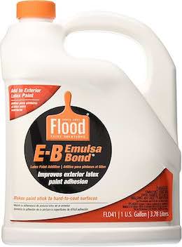

Direct-to-Metal Primer
Emulsa-Bond
A. The bronze is a dye that is sealed in, out of reach. So bronze tone aluminum windows would be painted the same way as natural colored aluminum windows. I understand that paint and hardware stores have paints meant for priming aluminum.
A. We are currently painting aluminum anodized windows that came in typical brown to match the trim on the customers house and have used D.T.M.(Direct to Metal) primer followed by two coats of flat paint (customer wanted NO sheen AT ALL) with no adhesion problems whatsoever.
I must say the primer was used at the customer's insistence only. I would have simply used Emulsabond in the paint, which would work just as well IMO.
