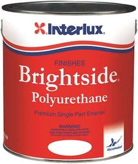

This is so you can better understand Polyurethane paint and its purpose. Note it says... frequently used for boats and marine applications. A couple of the desirable features to this paint on your aluminum boat is,
1. it dries very hard,
2. although it dries hard, it still maintains some flexibility which allows it to also resist scratching and chips ( like your car ), and
3. it is very water and chemical resistant. If you use a high gloss Polyurethane on your aluminum boat you don't have to put a clear coat on it. I still would, but I'm a perfection freak. This is why I stated it's use in my how to paint an aluminum boat post awhile back. Use Galva-lum primer. It has a very excellent adhesion and is compatible with the polyurethane paint.
What is Polyurethane Paint?
Contributor
By Stevie Donald, eHow Contributing Writer
Polyurethane paint provides a hard, durable gloss for crafts, model making and can be applied to almost any surface. There are several types of polyurethane paints, and several ways to apply them. The size of the project and the expected use will determine the best type of finish and method of application. You can choose from simple spray can to an extremely durable and high gloss two-part polyurethane paint.

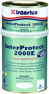

Interlux Interprotect Epoxy
Interlux Brightside Polyurethane

I am planning to renovate a 1962 Aluminum 14' V Hull Boat (for fresh water) and want to be cost conscious but also want the job to last.
I have read through many forums and product websites. To one of your earlier points "many ways to skin a cat",,, aka paint a boat...
For my Wildcat: (after degreasing, sanding away any loose particulates and washing with a phosphoric cleaner) I plan to apply (roll & dip) a two part epoxy primer "InterProtect 2000E White".
directly to the aluminum above & below the water line as well as on the interior aluminum surfaces. I also plan to use a one part polyurethane "Interlux Brightside".
for the exterior above the water line.
Questions: (Related to the Finish Quality & Durability)
1. Do you see any issues applying the 2000e directly to the aluminum as the primer vs. over the zinc chromates or phosphates as some suggest?
2. Do you see any issues leaving the 2000e as the exterior coat for the interior? I am thinking it would be durable and being white the gloss should be low enough to keep the glare down.
3. The boat is riveted and does not leak. Would applying a waterproof epoxy sealer Gluvit [affil links] be a waste of money considering it currently does not leak and will be applying the 2000E inside and out?
Bill Dean
- Lexington, Kentucky USA
Hi, Bill.
We try not to comment on individual brands like Interlux or Gluvit -- for one thing, it inspires shills to attempt to post with fictitious names and claim that "Brand X is superlative and Brand Y is worthless" :-)
The one-part polyurethane doesn't sound like it should be used on bare aluminum, but sounds fine on top of a two-part epoxy primer of any brand. I agree that two-part epoxy on both sides of non-leaking rivets sounds like plenty.
March 20, 2012
