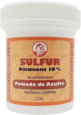

10% Sulfur Ointment
A. We found that sulfur ointment 10%, used for acne treatment is easy to apply evenly to the copper item you wish to antique. It is a thick consistency that covers well, and is very inexpensive from your local drugstore.
