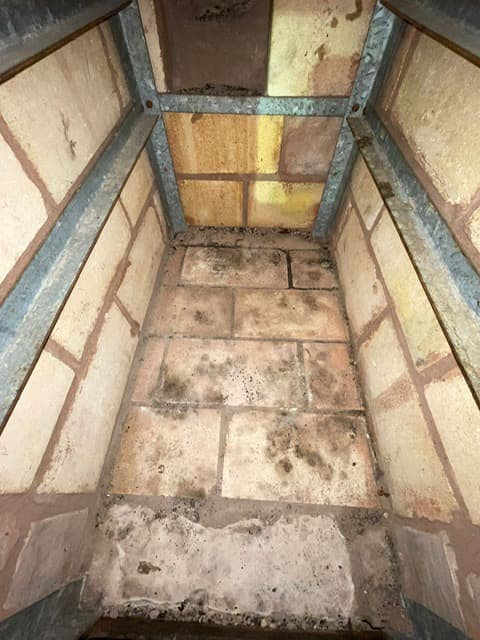

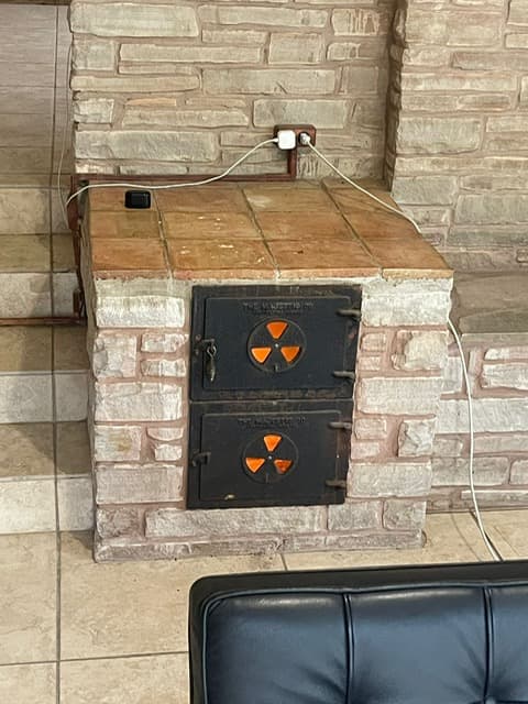

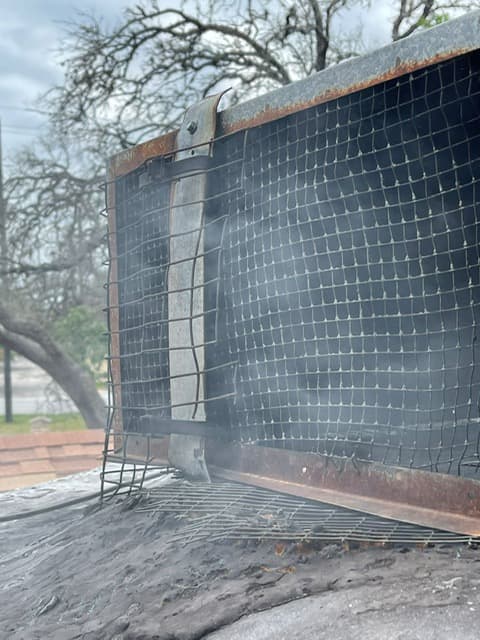

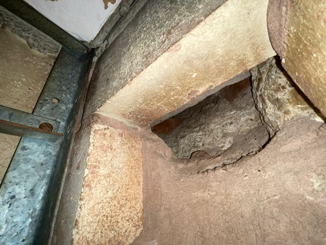

Q. I purchased a mid-century home that was built in 1957. It has 2 fireplaces with a Majestic Co stove built in. It appears the original top of the stove was replaced with Mexican terracotta tile. Someone told me it could be a baking oven because it has 2 channels inside for racks.
I am trying to find out if I need a top, or what the exact use of the stove is. I would like to use it as intended and get it back into original condition.
Any advice would be greatly appreciated.
paul orozco- San Antonio Texas
April 23, 2022
A. Hi Paul. I don't see a chimney so, sorry to say, but unless I'm misunderstanding something, this is never going to be functional. But it looks like maybe there once was a planned chimney, which has now been sealed off with concrete? I think it's a handmade galvanized frame connected to two doors from old stoves, not a whole original stove. If there is a functional chimney and it can be safely opened again, you still have a lot of work in front of you before a fire can be safely lit in there: I see no fire brick yet, and it's certainly required for the top, and maybe for the four sides as well (this is not a fire safety audit, just mention of something obviously wrong). There seems to be no soot, so I don't know a fire was ever lit in there. Maybe the builder decided halfway into the project that actual fires in there were a pipe dream -- but good luck. Luck & Regards, Ted Mooney, P.E. RET Striving to live Aloha finishing.com - Pine Beach, New Jersey Q. Thank you for your great insight Ted, I really appreciate it.
Once again, I appreciate all your knowledge and expertise. Paul Orozcohome owner - San Antonio Texas April 26, 2022 A. Hi again. My error! I misinterpreted the photo. I suppose it could be used as a smoker or, since it's an airtight stove, a source of heat. But firebrick on the inside of the top would be a necessity unless that parging on the underside of the terracotta top is fireproof and thicker than it looks (and even then it looks like it would crack and fall unless there is re-bar in it. Start with small fires until you're very confident it won't overheat -- airtight stoves are a bit different than open fireplaces because they can get really hot. I don't know if those creosote-burning logs you see on TV actually work, but you should try them periodically because you don't want to deal with a chimney fire in a chimney that doesn't sound very cleanable. Again, I'm no fireplace/stove expert capable of evaluating the safety of an installation from pictures, so it would be great if you can find a local service to take a look. (I saw your video of smoke coming out the chimney and, yes, we can post videos; but googledrive documents with privacy settings requiring asking permission to view them aren't compatible with our no-registration public forum). Luck & Regards, Ted Mooney, P.E. RET Striving to live Aloha finishing.com - Pine Beach, New Jersey Thank you so much for your time and expertise Ted! You confirmed our suspicions. We originally though that maybe there was an iron stove top for teapot or kettle type cooking. We thought about trying to either find a cast iron top but also had the idea of finishing out the top with firebrick and keeping it enclosed and using it as a smoker. I like the smoker idea best. - San Antonio Texas April 27, 2022 |
