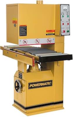

Try an abrasive belt on a ribbed contact wheel.
Wide Belt Sander
You didn't say what materials you were working with or how big they were. It sounds like sheet metal to me. If it is, you need to look at a wide belt application. Check out Timesaver or Somaca (SP?)
