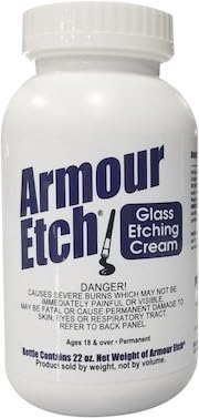

"Glass etching cream"
A. Craft stores often carry glass etching cream that contains ammonium/sodium bifluorides.
Deborah Morera
- Corvallis, Oregon, USA
