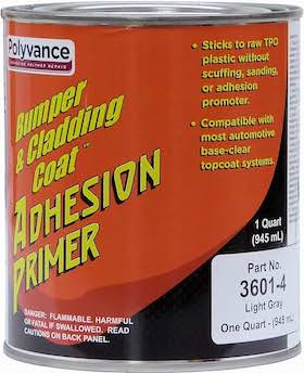

Bumper & Cladding Coat Adhesion Primer
A. OK, on the issue of painting polypropylene. YES IT CAN BE DONE! The bumpers on virtually EVERY car out there are made of Polypropylene or a blend thereof.
Painting it is as easy as painting everything else if you know what to use. First, clean the RAW plastic with a product called Super Clean Plastic Cleaner (part number 1000-A)
This will remove any waxes, residues, mold release agents, etc. Then spray a product called Bumper and Cladding Coat Adhesion Primer
on the plastic...
There is no need to scuff or sand the plastic.
Use a NON-Catalyzed paint to color it however you like. If you want to use a paint with isocyanates, you need to have a dry non-isocyanate containing paint in between...otherwise the adhesion will go out the window in a big way.
