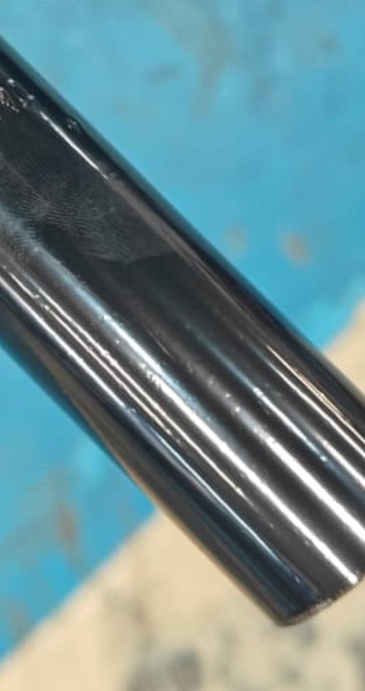

Q. Hi everyone,
I have the similar problem as Alexander but the difference is that powder coating is not only the source of pin holes. We are thinking that our die cast material is also a factor in pinholes. My question is "Which contributes the most number of pinhole defects between die cast materials and powder coating process and how can we reduce this defect by giving action on both factors?"
pinholes in powder coating
Bredix Duman
- Rosario, Cavite, Philippines
November 8, 2017
A. Hi Bredix,
To isolate if it is your Zinc Casting 'outgassing' which is causing the problem; after your usual pre-treatment heat the part to a higher temperature than the temperature used to cure the powder coating.
If the problem is still there, you may need to further investigate contaminants not being cleaned from the substrate, or Air-borne contaminants, residual contaminants in the application equipment from Non-compatible chemistries of Powder and/or possibly the powder itself.
It does not appear to be back-ionization in your picture, but rather a seed of 'dirt'. You can always reduce the KV & uA on your spray equipment to verify.
Check your part grounding with a Megger [on eBay or Amazon] , always less than 1,000,000 Ohms for safety, <500,000 ohms (or less preferred) for maximum transfer efficiency.
