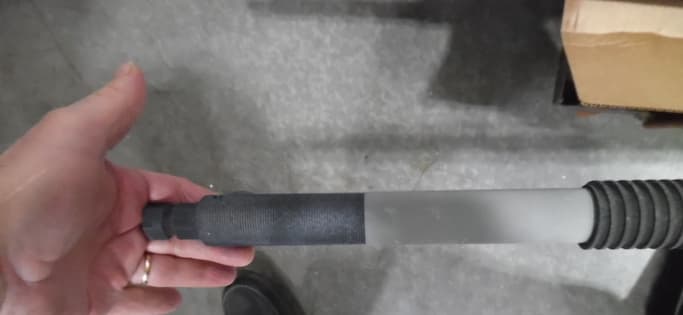

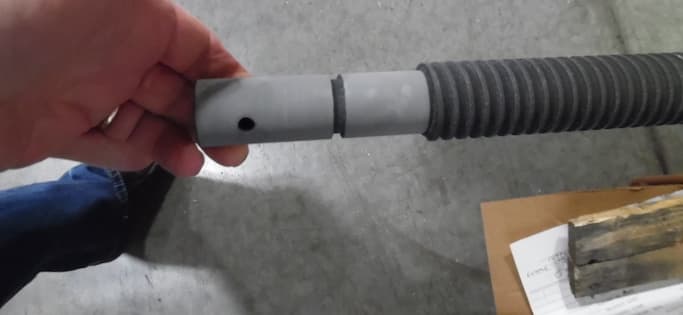

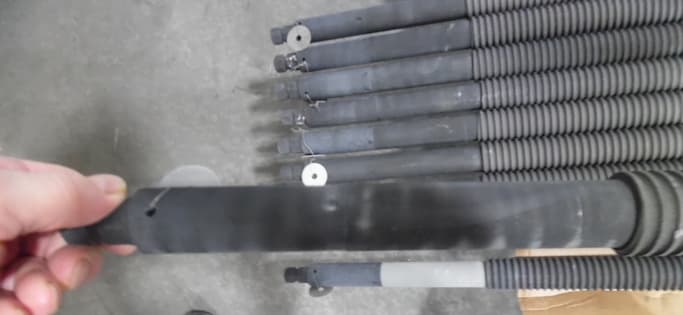

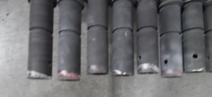

We have installed a new manganese phosphating line in our plant with the intention of obsoleting an old line. In our new line we are using the same chemicals (cleaner, grain refiner, manganese) the same time and temperatures and are coating the same parts as in our old line. The problem is on some areas of some parts the coating appearance from the new line abruptly changes from black to gray in random patterns. SEM analysis shows the lighter colored areas have smaller and more rounded crystals. This color variation causes issues with our inspection camera systems at a subsequent operation.
The old and the new line are both functional, so it sets up a great opportunity for testing, and we have done a LOT of testing! From this testing I feel confident that I can rule out a lot of possible causes like; chemistry, cleanliness of parts, tank size and agitation, and part spacing. At this point I have no idea what else the issue could be. I have had many experts come in and review our situation with no luck. Even though I don't think chemistry is the 'problem', I have tested a few different chemicals in case that could be the 'solution' to the unknown problem.
Does anyone have any ideas what the cause could be? Is there any situation where some kind of electrical charge could influence the crystal growth?
Thank You.
shop employee - Saint Johns, Michigan, USA
A. Regarding the black and gray. Go back and study the agitation of the grain refiner to be sure the grain refiner is hitting all surfaces.

Q. Thank you Robert for the suggestion. We have a propeller mixer in the old line and the new line. I have tried varying the speed of the mixer and using intervals of ON/OFF within the cycle but did not notice a change to the coating.
It won't be too easy to do but I could perform a test where I add part oscillation to the Grain refiner step.
Generally speaking is it a good idea to have the parts oscillating in the grain refiner tank?

Q. Good Day,
We have a vendor that processed some material with Manganese Phosphate per MIL-DTL-16232 [from
DLA]
, Ty M, Cl 2. The finished part has areas that are black and areas that are gray, almost like they were masked off.
A second part has a mixture of black with gray streaking; and 7 parts have no adhesion on the ends, base metal is visible.
I just need some ideas on what the issue(s) could be.
Employee - Milwaukee, Wisconsin
February 6, 2023
1. Ask him if he uses a grain refiner and how he controls it.
2. Ask him if he adjusts the total/free ratio immediately before putting the parts into the tank.
3. Ask him how he controls the powdery sludge from settling onto the parts.
February 7, 2023
