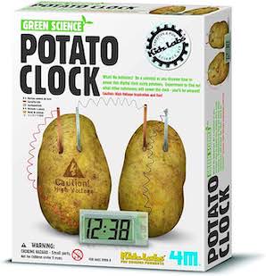

Potato Clock
A. You can get a "scientific toy" called a "potato clock". It comprises a small LED display and a few pieces of wire that are attached to a piece of copper and a piece of zinc. You connect the other ends of these wires to the LED and put the copper and zinc into to potato. Lo and behold, the clock starts to go and will go for a go few weeks until the potato shrivels up. the clock will work with most fruits, such as apples, oranges, peaches, grapefruits etc, but it is not very good with vegetables such as brussel sprouts or cabbage!
