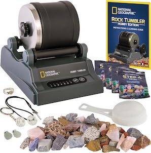

A. Hi, folks. My bet is that the best way to do this is with a rock tumbler [affil links] and a soft media like corn cob. The corrosion and discoloration will be softer than the raw metal and I think you can tumble it off then stop before you appreciably wear the markings off the coins. This is just a guess though.

opinion!  After extensive research, I've found that you absolutely do NOT want to use salt, toothpaste or omg a ROCK TUMBLER??! WTH!? If the coins are valuable that is. I really cannot understand why people post awful things like that. If you don't know what you're talking about don't answer. PLEASE!

But a number of other situations are mentioned on this page including fire damage to "a 5-gallon bucket of coins", salt water damage to "loose change in a tall plastic container" and "a large container of coins not of the valuable sort". Please consider the possibility that people are discussing different situations than you have in mind, not necessarily posting "awful things ... omg a ROCK TUMBLER??! WTH!?".
