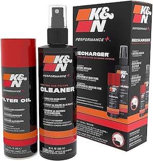

A. FYI, sodium metasilicate pentahydrate is the single chemical in K&N [brand] "Air Filter Cleaner" [UPC: 0 24844 00030 9] ⇨
for their line of semi-permanent auto engine air filters. It's available at virtually any California auto parts store, so presumably in all other states also.
The K&N product number is 99-0606, also in a kit 99-5000.
There is no indication of what the strength/dilution is, but it doesn't damage the air filter fibers or rubber filter frame.
I have no affiliation with this manufacturer.
