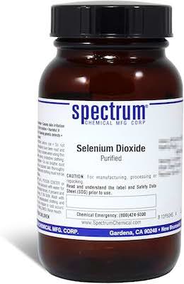

A. Selenium dioxide is a fantastic chemical for blackening copper and brass. In fact, it is the chemical trophy engravers use on a laminated brass plaque to make the lettering black (the lettering cuts through the lacquer). It's totally jet black and very hard. The product they use is called Gravoxide or oxidizer.
It's more readily available in Birchwood-Casey Gun Bluing this on eBay or Amazon [affil links] . It's advertised as a blue/black oxide finish for steel but it is very effective on brass/copper. Brasso this on eBay or Amazon [affil links] polish does not readily remove this finish.
I'd recommend an acid pickle to remove existing oxide or whatever method you have to get the metal very, very clean first.
