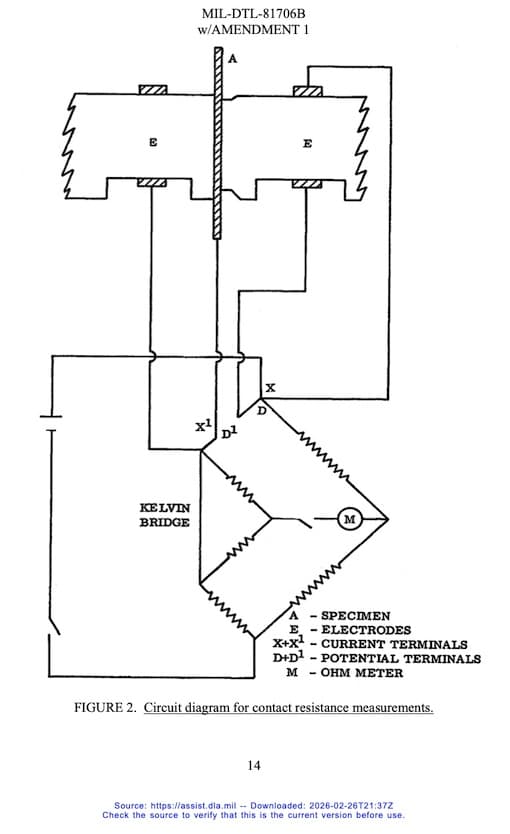

A. See MIL-C-5541 or MIL-DTL-81706 [on DLA] for test panel preparation and salt spray requirements. The conductivity testing apparatus and procedure are given in MIL-DTL-81706. Conductivity of Class 3 coatings is measured both before and after salt spray testing. Briefly, contact resistance is measured by pressing a flat test panel between polished copper blocks. Both specifications are free downloads at the ASSIST site: http://assist.daps.dla.mil/quicksearch/.

See MIL-DTL-81706 [on DLA] for the testing apparatus and procedure.

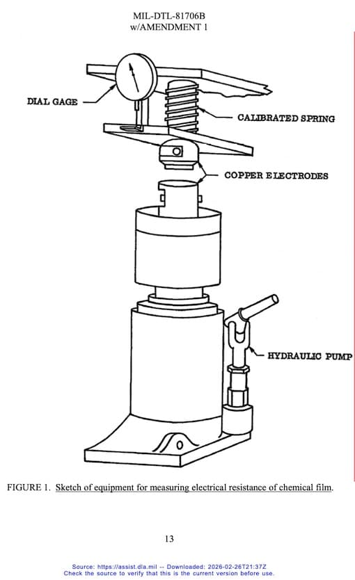

Q. I am developing an aluminum sheet metal part that will be chem filmed and must meet MIL-DTL-5541 [on DLA] F, CLASS 3. Where can I buy the equipment to measure a resistance not greater than 5,000 microhms per square inch with a nominal electrode pressure of 200 psi?
Mark Stauder
Mechanical Design Engineer - Irvine, California
A. Build it or buy it! We tried for years to locate such a piece of test equipment and finally we purchased a load cell to measure force, machined a copper electrode 1" x 1", and put the unit into a hydraulic controlled anvil press. Using a simple amp/volt meter between the copper electrode and the test piece we were able to measure the surface resistance. The alternative is to have an outside electrical testing house measure it for you which is often easier and cheaper when you factor in the cost of calibration. Lastly, once you've settled in on a chromate product and defined the process needed to stay below the maximum resistance, you'll find the result doesn't vary.
The spec you reference doesn't require that you measure the resistance (whereas AMS2473 might), MIL-C-5541 Class 3 requires the use of a QPL-approved product which has demonstrated its ability to meet the resistance requirement when operated per the manufacturer's data sheet.

A. Not sure whether these are commercially available.
The design is relatively simple. See MIL-DTL-81706 [on DLA] B CHEMICAL CONVERSION MATERIALS FOR COATING ALUMINUM.

I'm interested to know how or where I can get the equipment for measuring electrical resistance chemical film (Class 3) in accordance with MIL-DTL-81706 section 4.5.5.
With Best Regards
Sim Boon Tiong
November 30, 2015
A. Sim,
First: Usually this type of testing is only required when you are developing a chemistry for applying the chemical conversion coat. If that is your goal then you are correct that the testing needs to be done before it can be submitted for inclusion on QPL-81706.
Second: In my 32 years in metal finishing I've never seen this equipment offered for sale by anyone. I'm not saying it isn't, but I've never seen it. Companies usually build their own or they send samples out to an approved laboratory that already has the equipment. It would most likely be less expensive to send it out unless you plan on performing the test frequently. The one and only time I've ever been requested to test the coating, I sent samples to a lab in California that performs this test.
